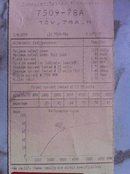

This came with a rebuilt revised squareback.
The output test was done at 13.2 Volts so we can't compare with the shop manual. Clever. :(
Field current draw is 6.8 amps. Well out of the acceptable range in the shop manual specs for '69, but presumably in range for whatever years revised squarebacks were produced.

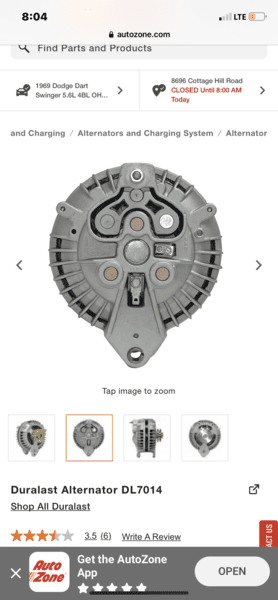

Autozone still offers round back alternators in single/dual pulleys in various amperage, single wire, limited lifetime warranty.
I ran a DL7001 (60 amp) for years on my 67 A100 (that called for a 46amp) with a new electronic replacement VR. All wiring in my van is original, no meltdowns etc.
Grab a DL7014 (50amp) single groove pulley if you’re concerned about too much amperage. Paint the pulley black, or pull it and install an oem one. Done.
Simple as that.

Interesting, that alternator does not fit my 70 318. Must be the "plug clocking position @ 6:00 position"
Lack of rebuildable cores is the problem. I don't see any roundbacks at Napa or O Reilly. None listed at Autozone either. Edit: I best look back at O Reilly. Rusty said they have some listed.
Damn I was wrong. I must have looked up one for my 70. I didn't find the DL7014 at Autozone that 12many found and the R111598A that O reillys has listed that Rusty found. I was looking for something lower amp than 55. Damn, I feel bad for the wild goose chase.
