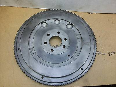

Because 360's are externally balanced you should probably have a 360 flywheel. They may look like this.
As stated, get the correct flywheel for you application. i.e. internally or externally balanced. Trying to drill for externally balanced engine will be a disaster.
