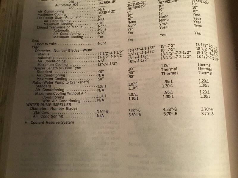

        Here's the deal with the water pumps. Cars with lots of accessories like AC got the 8 blade water pump because those engines were dragged down and got a little warmer running all those accessories at idle. Mopar performance recommends use six blade simply because there's less drag and they don't expect you'll be idling much. If you have a hot Street motor strip motor and you're driving around town you're really going to want the 8 blade pump because if you do any kind of sitting in traffic drive-thru your motor is going to get a little warmer than norm.
        The other thing to consider is that Mopar and they're testing came up with an idea that the eight blade might cavitate at really high RPM. I run the eight blade myself and have no issues running it at high RPM ...and you really don't stay up there long , so it's not an issue. That was more of a racing thing.
        Six blade, I have no use for them.
        8 blade for street strip.
        Add the anti cavitation plate version for constant high rpm..or buy the milodon,jegs,flowcooler.. etc version.
        And a caveat to that is you can run a 6 Blade with a plate and probably push about as much water as a regular 8 blade.
        You can do it a couple different ways.
        Parts store 8 blade-cheapest.
        Jegs 6 blade w/anti cavitation plate-70.00 iirr.
        Milodon and the rest are the more $$.
        All you need.. is what works.
        Mostly is lack of enough low rpm clooant flow that's the issue.

                        Fact. They put both behind both depending on the app. I've torn apart more cars, trucks, Van's than I could even count.
                        Pop quiz
                        ..The impeller shaft is bigger on one pump than the other, which is it?
                        Thanks for playing.
