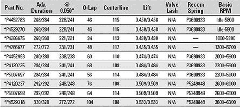

Hi all ,
Just looking for thoughts on a set of springs on a 484 Purple shaft cam ( I know old cam ) in a 400 bbd
I THINK the answer used to be the standard hemi springs...933's iirc. Let me find the cam page...
See this link....
I dont know what the modern equivalent is
I've used stock springs multiple times with no issues. There may be better options, but they've worked fine for me.
Hi all ,
Check the MoPar engines book for spring specs and then make a cross over to another manufacturer if they are not available.
The book gives the open and closed pressures at the suggested spring height stalled and at a certain lift. Spring pressure rates are also n the book.
It should be fairly simple.
