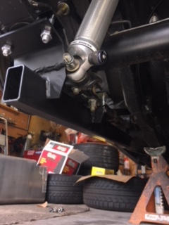

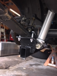

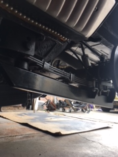

I've always had to cut and weld the Lakewood bars I use to get proper fitment. The do stiffen the rear ride slightly, but the increased traction they provide is astonishing. I also cut the rubber snubber in half to decrease it's deflection under load, and use stronger mounting hardware than comes with them.
