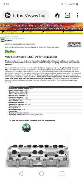

Edelbrock 61729 Victor Series Cylinder Heads, SB Chrysler
Follow the link, you can download the head instruction sheet. Edelbrock says it uses stock big block rockers with at least .150 intake offset. So I would assume big block rockers on small block shafts.
Thank you. I went looking for the offset on std bb rockers and could't find it but the article I read said even bb factory adj rockers would work. I just want to find out what shaft and spacers, mounting stuff I need to compliment. Do you happen to know the factory bb mopar rocker offset? I don't have any bb stuff anymore.

Thank you, I left a message for Dave to call me back. They are short handed right now. Can you tell me if that .180" is a standard offset for bb mopars rockers?
