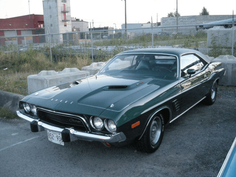

By the way, I like the green color. Attached is a photo of a 74 Challenger Rallye I owned about 10 years ago, also green exterior, interior and vinyl top. Bought it from the original owner in 2002, with 32000 miles on the speedometer. 360 4BBl. engine with the 727. Another MOPAR I should have kept. :thumbsup:

That Challenger, though.... holy crap. That is beautiful. Kick yourself once for me. What did you pay for that in 2002?
