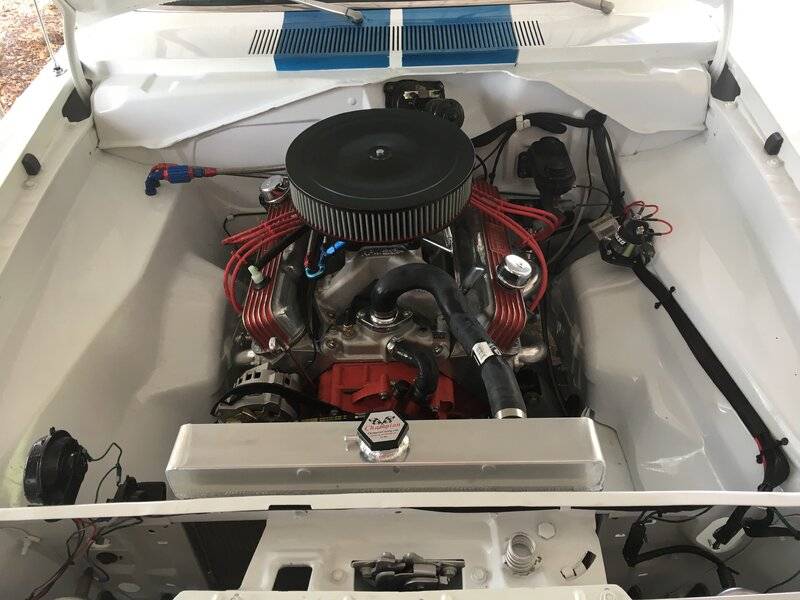

Yes, with the Mopar Performance repop of the OEM early 340 air cleaner. Here's my 67 Barracuda with 360 and a 750 Holley.
