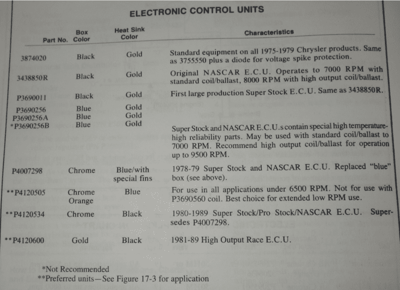

1971 Demon with Hi Rev 7500 4 pin box and single ballast.
I have a NOS Accel coil from 1999 with a measured primary resistance of 1.2 ohms. Will the system function as designed if I use it?
(I forget the number, but it is not the plastic Super Coil)
Thanks FABO
Depends on which ECU you have.
