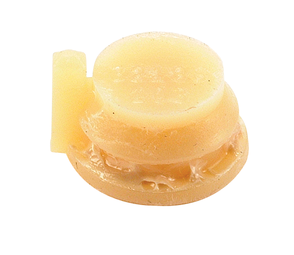

If you remove the glove box the passenger side pivot and linkage should be accessible without having to crawl under the dash.
The linkage bushings are available in the "HELP" section of tsome of the parts stores and look like this.

Hold on a minute. If you can hear the separated linkage moving with the right pivot post, the linkage is still attached there. It separated ( plastic bushing failure ) all the way over at the left pivot attach point.
To explain, The motor drives the left pivot with one linkage. The left pivot drives the right pivot with another linkage. There are 4 plastic bushings involved. All have the same age and wear.
Taking the glove box liner out will likely happen but that's the easiest step of a proper repair.
