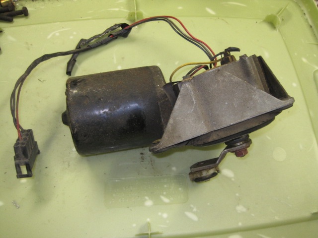

I will take a picture
I have the nut that holds the linkage on the motor, if thats what you mean.

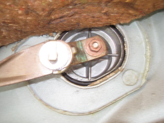

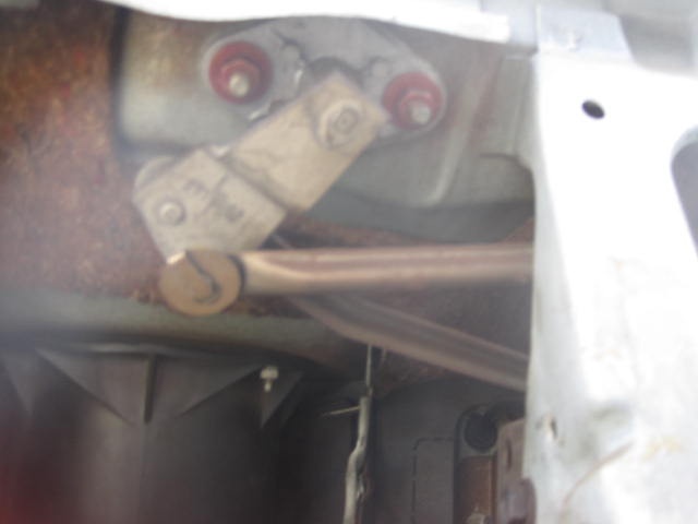

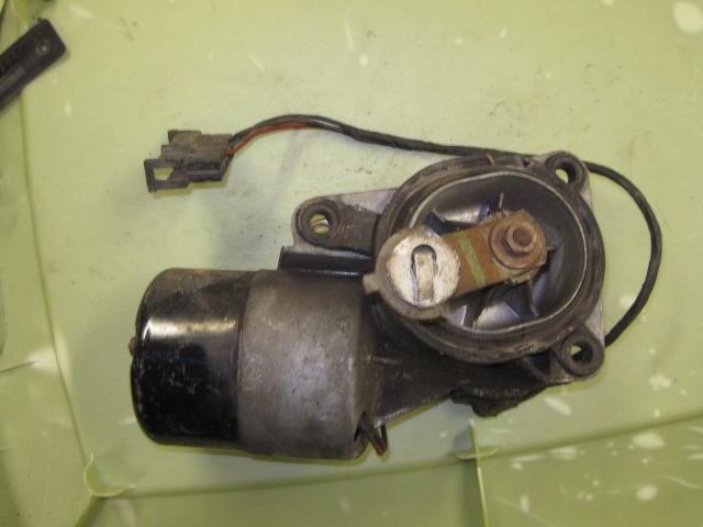

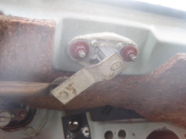

close up.There is a plastic spacer/bushing that goe on the linkage to motor arm

I guess i'm mising the Z shape bracket too #-o
I will have to look for that too in my parts bin
I have a spare if you need 1. I may also have the bushing and clip too
