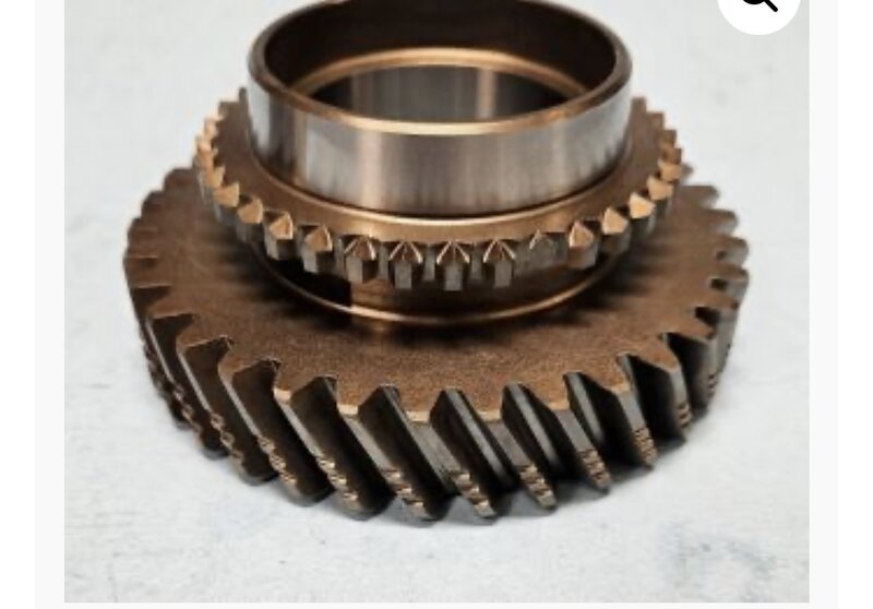

Like the picture
Brewers has them new. Used gears may look good to the naked eye but there are 9 teeth that hold it in gear when you leave off the throttle. If worn is very hard to see. Just went through this with an early trans and Dan from brewers transmission helped me out and schooled me on it. unless they drove the car the gear came from how would they know its good. I believe they can be reconditioned
I know that Brewers have has them -just trying to save a little money -and I’m quite aware of the problem that you’re talking about. I check for the perpendicular lines of the engagement teeth while viewing them directly over the top- They would have to look good in a close-up photos before considering it. Thanks for your input.
I could barely see what Dan was talking about Over the phone in person. It is only one side of three teeth every third of the way around. I could see the teeth 3 in a row because of a different shine then the others . But I could not see the wear.
I took Dans word and I'll be dammed if he wasn't right. Trans worked perfect after the new second gear.
Before I replaced that gear I was playing with linkage and trying to find anything wrong. This was a trans we bought used. We put everything in the trans new . Bearings and synchros and input shaft. The trans worked perfect but at times it would pop out of second. The new gear was the right call.

"I believe they can be reconditioned"
You got that right. I have reconditioned many, and in all vintage makes.
In fact, all the gears in my early-60s Commando box have been reconditioned, and the sliders as well, and some, more than once.
However,
Since I have many years experience doing it, I am reasonably confident, that I can easily recognize trouble spots. A833s, IMO, are one of the easiest (next to the Saginaw) transmissions to work on, and the gears are seriously robust. The clutch-teeth can be doctored many many times.
My Commando is about 60 years old. My 2.66low, is about 56 years old. My od-boxes are early 80s. AFAIK, there is not one un-original gear in any of them. Sliders I cannot swear to, lol.
Brass rings on the otherhand, I keep spares.
Cluster-pins from A833-transmissions running ATF are probably the quickest wearing parts. But the pins can be turned, re-keyed, and reused, with new rollers.

While the trans is apart, on mine, I modify the cones to shed oil faster, and to bite harder on the brass. And of course, I slick-shift Second and sometimes Third. When this is done right, the guy on the shifter can easily overpower the brass, and the beastly A833 can shift as fast as anything. And yet, having left the brass in there for street-duty, you can granny-shift it too. Win-win. Oh and, the brass lasts nearly forever.
