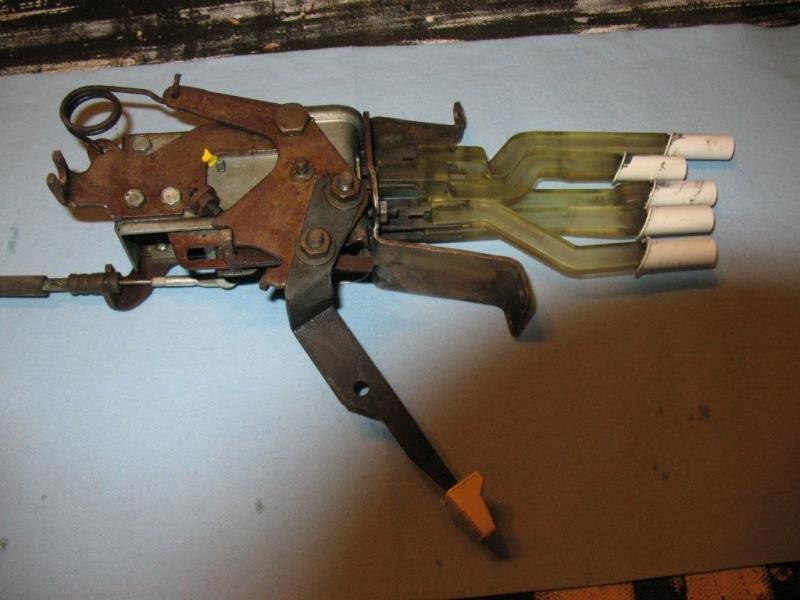

looking for a pushbutton assy for a 62 dodge lancer. haven't pulled apart yet, but missing the neutral button, and don't see any rod to put a button on. won't know till i get it apart, but thought i would start looking now.
just bought the car, and have no history on the missing button issue.
here is a picture of a pb assembly from a 61 valiant-- very similar to yours,
I believe the mechanism is the same for all the pb-- the levers are specific to the model of the car.

my buttons are black and rectangular. i am told that the button and lever are one piece?
won't really know till i get it apart, are the buttons on yours rectangular?
the picture is for reference-- the mechanism is the same for the push button cars-- the difference is the levers -- this car had a clear style-- the levers pull out of the metal fork--. Lawrence

i found the missing (n) button laying in the bottom of the dash after i got the assy. out. the reason the button fell out is that the metal fork that holds it has the bottom fork broken off. thus i am looking for a replacement shifter assy. if worse comes to worse, i could probably take it apart, and make a new shifter lever and fork, but there are a lot of parts inside that thing. i am told that they changed the shifter assy for 62, but that valiant one sure looks very similar except the front bracked.
anyways. need to know the interchangability of the shifter assy's.
looks like the 62 valiant is missing the neutral button too? seems to be a common problemwhen you "pull" on a "push" button, as in putting it in park
chuck you need to see what newmex guy wants for his push button assembly-- I bet you could swap your park brake assembly to his shifter assembly & have a decent unit ,Lawrence
i picked up a 62 unit from hyper_pak from a b body. it is different than mine, but as you said, i am hoping that my parking brake assy, and reverse light switch will bolt to it, and i'm not sure about the levers, although they seem to be in the right place. i have put the old unit back in the car for temporary. and after this last winter storm we got here, who knows when i will be working on it again.

Generally Vdart is right. The base mechanism is the same for many years with the only differences being the bolt on mounting bracket and the push buttons themselves. I have a mechanism for the '62 in fine shape if still needed. PM if interested.
i got one from a 62 b bodie, but it does carry a different part number accordibg to the book. i don't know when i'll get around to trying it in the car. . will pm you to see what you are asking for the correct one
problem solved!!!
thanks to all for the input, and valliant patrol for the 62 valliant unit. i compared the 62 a body, and the 62 b body units, and as vdart said , they are the same base unit. with the exception of the reverse light switch location and the park levers etc.
the little spring that is part of the neutral lockout lever was broken on both. i ended up making new ones of those (real fun). that must be a problem point in these shifters.
