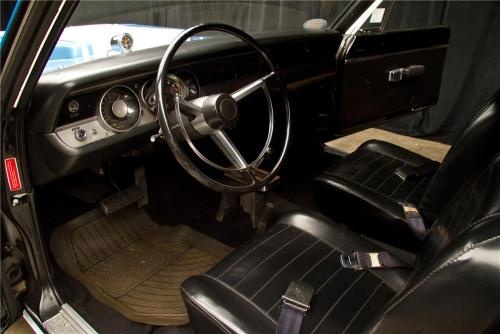

I'm looking for the standard wheel horn trim for a 68 Barracuda, or other mopars that this style wheel was used. Does anyone know where I can find this horn button and trim? Also maybe some advice on what model cars this wheel could have been found on other than the Barracuda and Coronet?
This is the steering wheel I'm trying to find or make using a classic industries repro wheel.

I'm not trying to get in the way of a sale, but I believe the picture you show is a 1967 steering wheel, and the wheels did change for 1968. Look at the post below for a 1968 steering wheel.

you are referring to the optional wheel that appeared in 68 and came either color keyed or woodgrain .....that was an extra cost optional wheel from 68- 70 (68/9 A-body) 68-70 B-body)
if the new car buyer didn't want to spend more on a steering wheel in 68 then they got the same basic wheel as 67 but the centers changed. All the centers interchange on the same basic standard wheel as 67
examples are: the same re-pop classic wheels with different optional centers. 68 and 9

I want to put this steering wheel horn trim in my 1970 Dart with a reproduction standard wheel from classic industries, but I cant confirm if the 67 wheel will fit the column properly or would it be more logical to buy the 1970 wheel
1970 changed so the older wheel will bolt up but it wont look very good. 70 was the first year the key was mounted on the column so the column diameter at the wheel opening end got larger
some trim will interchange from 68/9 to certain 70+ wheels but the basic wheel stating in 70 is different because of the center hub diameter
