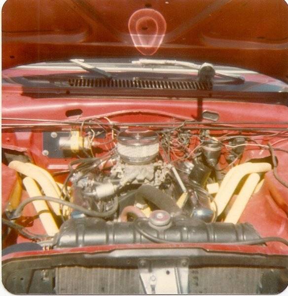

Sounds like my 273 68 Valiant build.904 and 2.76 gears. Turned out to be a great cruiser,drive anywhere car.Not a powerhouse but still fun and sounds good.
Why do want later LA rockers? The '65 adjustable rockers are to die for! I used them on my .58 lift 312 duration solid lifter camshaft.

When I was bracket racing my 273 '65 Valiant (pictured above) back in the '70's using the factory stock cylinder heads, I noticed after making a quarter-mile run a few drops of coolant scattered about the engine compartment without signs of a leak anywhere.
Later, when renewing the cylinder heads, we found a very minor crack in a water jacket. Back then, I never paid any attention to casting numbers, so now I can't identify the cylinder head we scrapped back then.
