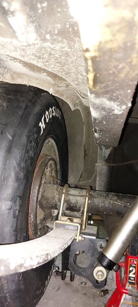

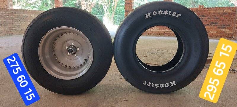

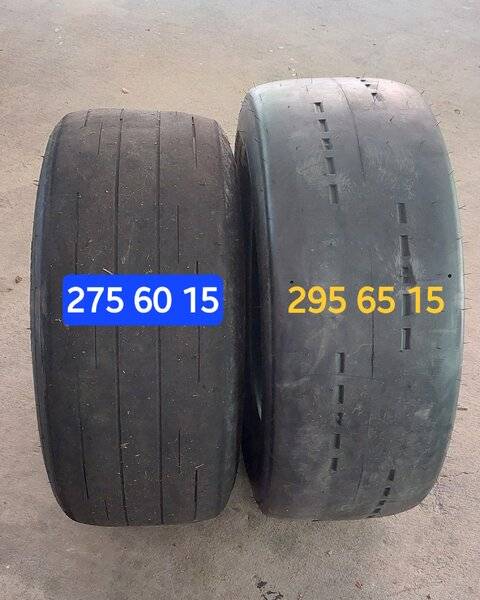

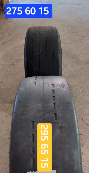

This may be a left question.. Does anyone have a photo of a 275 60 15 next to a 295 65 15 or even a 295 55 15 side by side?
Anyone have a photos with 295 65 15 on their car? Im thinking about getting them I like the tall tire look..
That's a 30" tall tire. That would require a full tub in the back and quarter work. For stock outer wheel wells and quarter openings the limit is usually around 28" tall, and even that usually requires shifting the rear axle back to center the axle in the wheel opening.
Thank you for the info, 28s it is ,now Hoosiers or MT
