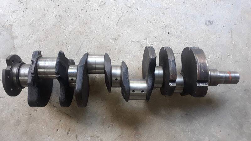

Can anyone post the journal size for a 383 crank. I have this one looks nice and clean . I only have a digital caliper to check this, but it only reads 2 decimal points.
Just wondering if this is standard or has been turned some.
Here is what I get with my" cheap 0" calipers.
Thanks for any help
Rod journal size , 2.3740" - 2.3750"
Main journal size, 2.6245" - 2.6255"
These are for a "standard" size.
Just wondering if this is standard or has been turned some. View attachment 1715769266View attachment 1715769267
Thanks for any help

So no way to determine if this is std or .010, .020 under ? I need a Mic.

Well ya, LOL. that's all I have to work with. :BangHead:
I was just trying to check it. Guess I need better tools !

I used to have a nice set of Mics but didn't use them for years, eyes have gone south , even with glasses and couldn't read them anymore. Guess I make a trip to HF. SO you think this crank could be STD ?
I do.
