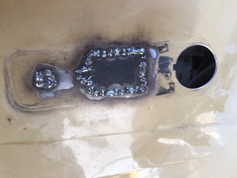

Can’t help you with the placement, but the ‘68 markers are by far the easiest to add. All you need is a round hole with a notch, nothing recessed.
A harbor freight step bit
File a notch
And voilá
