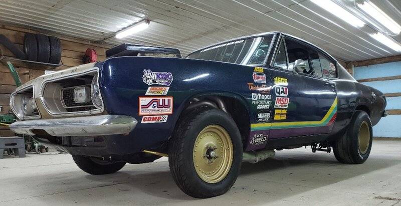

Here is a picture from last year that might give you an idea of how low it hangs. If it was below the K member, it wasnt by much. ZERO issues with steering. I even ran a cheapo diaper on it at the track with no issues.
Awesome, thanks for the pic! I run the 7 quart Milodon pan because it used to be a racer, it makes me nervous on the street.
