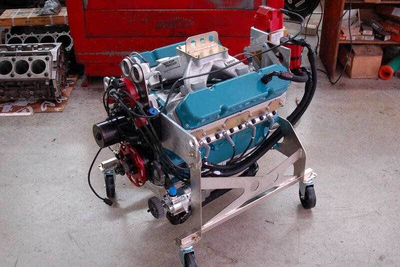

I've built a bunch of 400 based engines over the years. The 512 is a good street combo, the 470 makes a nice race engine. 700 hp is fairly easy to make with Trick Flow 270 heads, 800 hp can be done, but is probably at the limit of a stock block. This pump gas 470 made 780 hp.

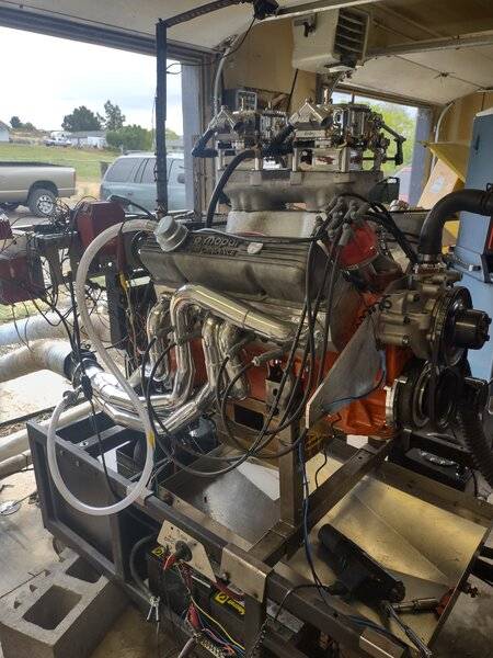

685 HP at 5800 661 tq at 4800
470 nothing fancy. 240 tf's , smallish solid flat tappet cam, home welded and ported tunnel ram with 2-850's
Alot of extra work making sure it was as good as I could make it.
Will easily make over 700 HP with a optimized solid roller, But like Andy said 700 is pushing it with a stock block.
I'm hoping to get some passes with this sometime this season

How heavy is the car approximately?
It's not completely put together but I've weighed everything that will be going back into the car including fluids and myself wearing a helmet and suit should be around 2900 ish
All steel besides the direct connection pro stock scoop

That looks badass just sitting there. What were the cam specs again?

Would you look at all of that.
That's about what I'm looking at for my 470 build when I get to it. Minus the TR though. Can't wait to see the hotrod of yours make some passes.
Me too, hopefully you can get to your 470 pretty soon. The cam is from Hughes, I bought it 2nd hand from a member here. What were you hoping to do for intake and carb ?
For my build, I was recommended something in the 260's @ .050 and around 0.650" lift, so similar to yours. I've got a Victor 383 intake and a few 4150 carbs to choose from (2 different 950's and an old school Holley 4781 850).
What is your compression ratio going to be ?
