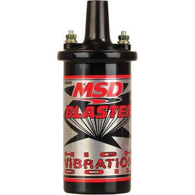

MSD 8222 can be mounted anyway you want. It’s epoxy filled, no oil.
Bingo! Winner! Bulls eye!

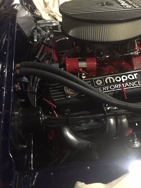

I made my own 6 pack coil bracket to fit the Weiand dual plane intake. Members here suggested it. I used a generic coil bracket to hood the coil and bolted the chrome bracket to my home made one.
Sorry, it’s the only picture I have on the phone.
