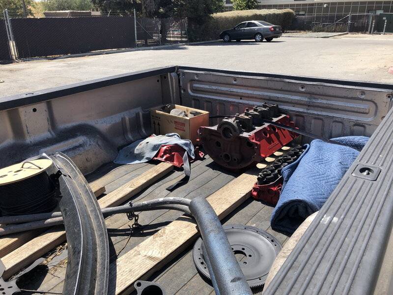

I didn't want to try and chase down the power issue and that just confirmed the plan to go with a V8 upgrade. Two weeks after getting the car I was able to track down a 340, complete. My friend and I went the three hour drive to look at it, he took time to mic the crank, bores etc. and verify everything was there and serviceable. The block was already machined to 0.030, the X heads were untouched. It came with everything for the most part intake to pan. Correct exhaust manifolds and intake, windage tray and hardware, timing cover and one valve cover were from a much later year. On the way home we dropped the block and heads off at the machine shop, the block needed to be honed to cleanup some very minor surface rust and the heads a full build.

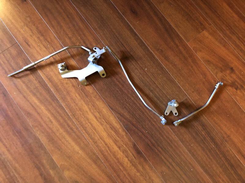

Now the parts hunt is on, throttle/kickdown linkage was sourced.

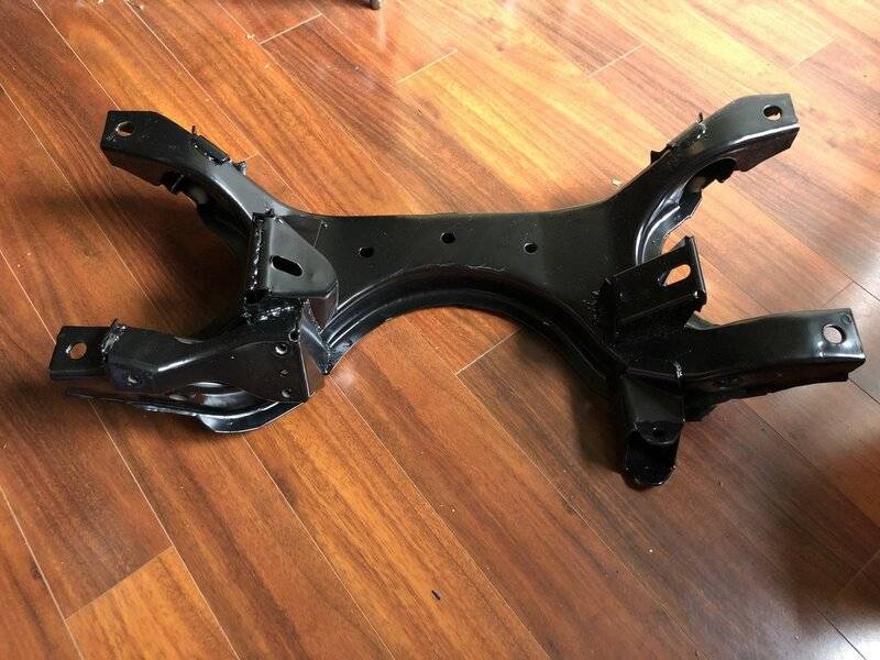

8-3/4 SBP 3.23:1 open rear was acquired drum to drum, serviced and ready to assemble. Not even two months into this and a V8 k-member was located and power coated.

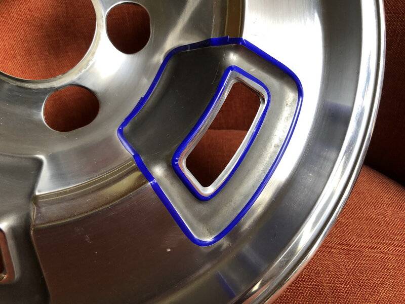

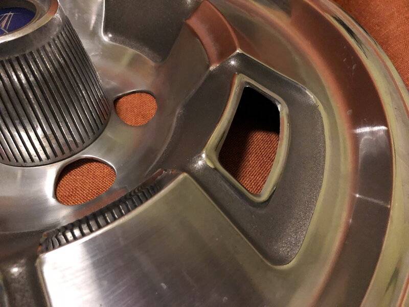

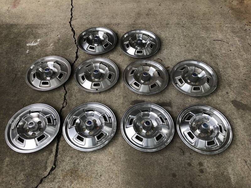

The wheel covers are the same Bolt-on style as the fastback so I had a small inventory of them along with the ones from the car. Most of them the argent had faded so I felt now was a good time to freshen up a set. Very time consuming.

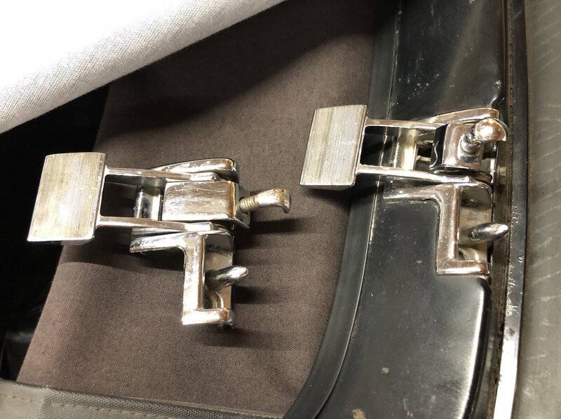

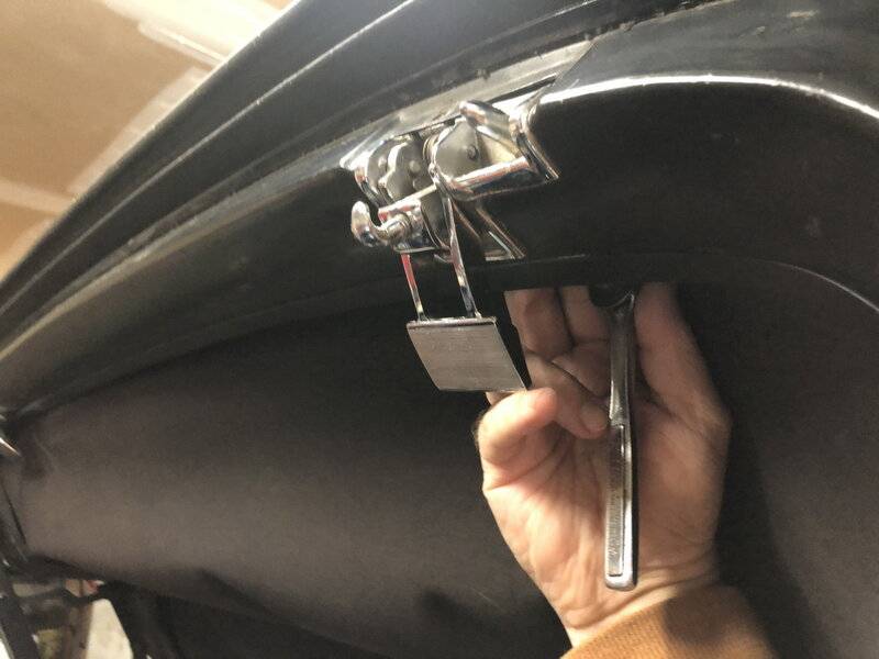

One of the top latches broke shortly after getting the car. Just a cosmetic element. Replacing it was not easy, limited access.

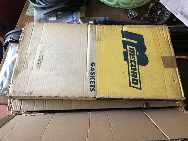

Back to the engine. One thing I knew would be difficult and expensive to locate was the left side exhaust heat shield. In my regular daily eBay searching a listing popped up for one, once I gave it a quick lookover to confirm it was a 340 piece I hit the $35 Buy-it-now (plus $85 shipping), in a couple weeks I had it, shipped from Germany. To my surprise there was a second one in the box. It is a McCord part, McCord was the original manufacturer for Chrysler. The only difference in this one is no Pentastar or Mopar part number.

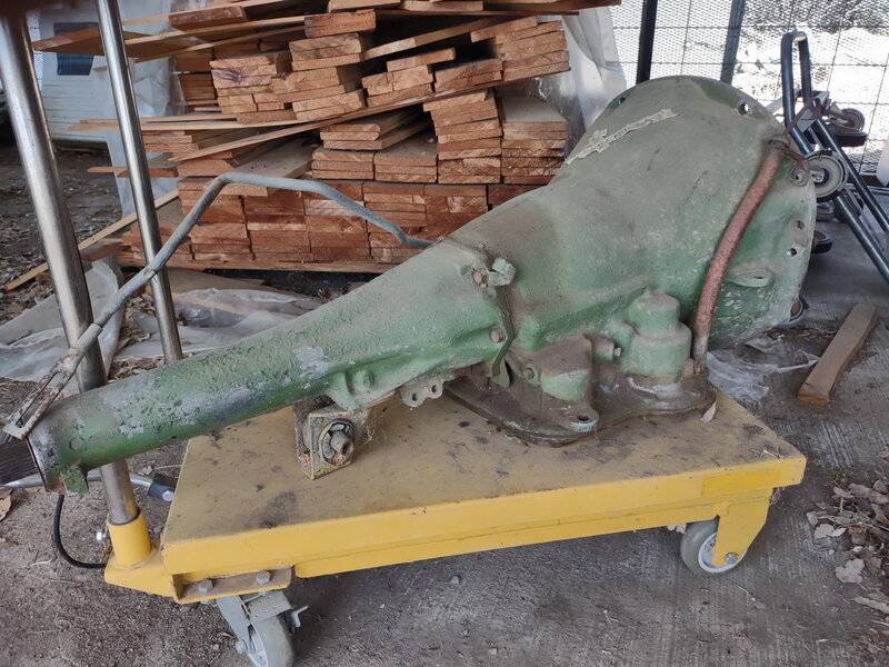

On the way home from Oregon on another trip i stopped by Accurate and picked up a complete exhaust system (the two larger boxes are for a friends C-Body). Further south I stopped at the friends place and picked up the free transmission.

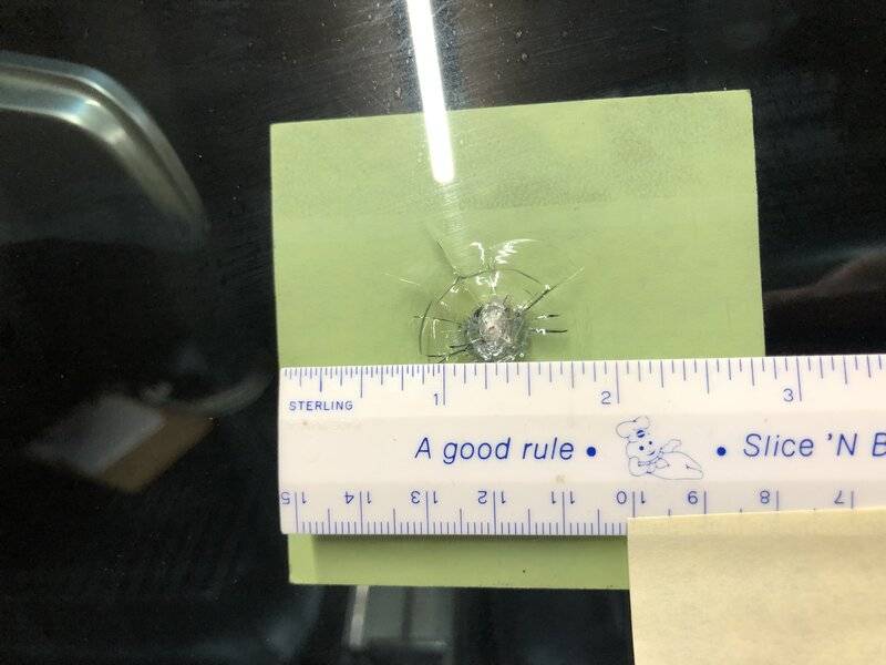

On the way home from Oregon the car got hit with a pretty good size rock, I have a new windshield, still need to have it installed.

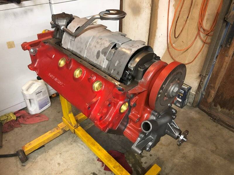

Once again back to the engine. By now I have all the parts back from the machine shop and have acquired everything else that I should need. Overall the build went smooth.
It is for the most part a stock build, not going to cover in detail.
First up was to clean all the oil passages with long bristle brushes, WD40 & Brake Clean.
Needed an undersize timing chain.
Timing cover, dampener, water pump, windage tray, oil pump and pickup.
Oil pan
Heads, valve train, intake and bracketry, not seen, 90^ oil adapter.
I was able to locate a good 340 valve cover but the wire tabs needed to be replaced, new ones have been welded on, just need to clean these up and put them on.

would you sell one for more then you paid
No, you never know when you may need a spare. It is hard to say when or if these will ever be reproduced.
Wow, hard to say you were lucky.........Mine came through the open side window and hit me in the chest.
I saw this coming from over four cars, I thought it was coming through the glass. Not little gravel, just glad it didn't hit paint.

As I'm putting a new k-member in the install will be bottoms up.
