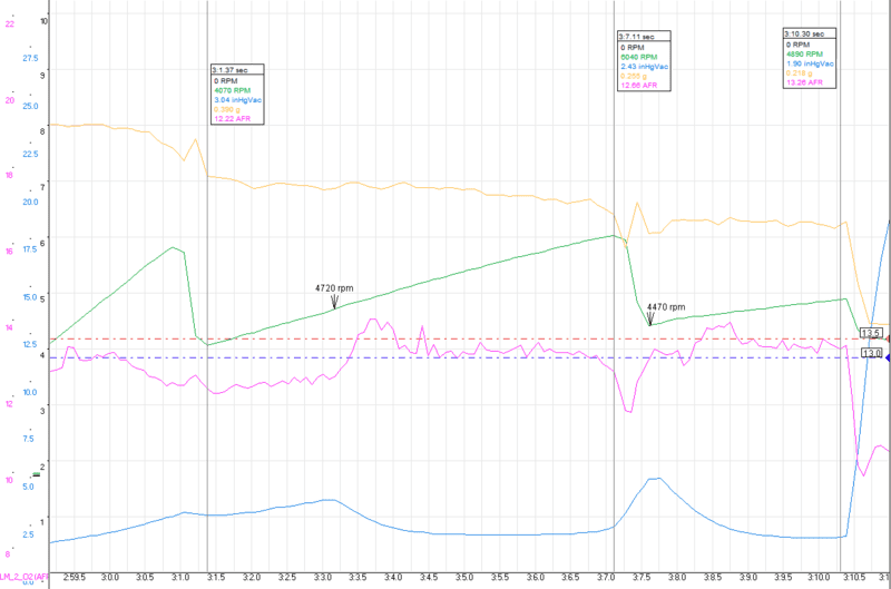

I was downloading some AFR data (road testing the logger setup) with a jetting change and it led to looking at some older dyno data.

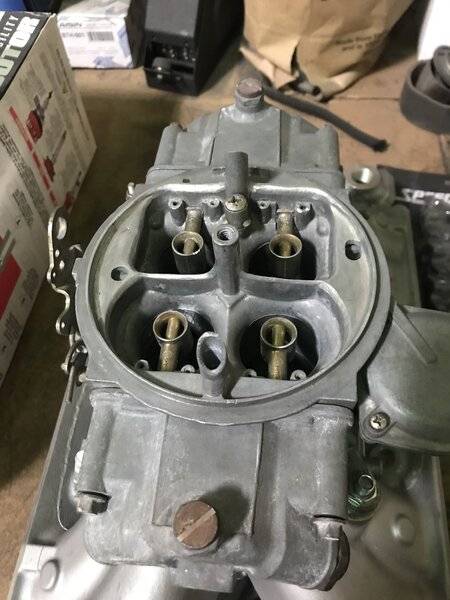

Long story short, the 750 cfm Holley currently on the engine was modified with annular boosters in the primaries and downlegs in the secondaries. However it never performed as well on the chassis dyno as it did with the plain ole '650'. Both are vacuum secondary 4150s.
After the 750 was modified, it ran very rich and its taken me a while (a long while) to get it pretty much in balance. I just leaned the main jetting a little more and was looking at the road results. It occured to me that the I might have a dyno run saved with 650 that had relatively rich AFR. If so, would it have similar power as the frankensteined 750 had when it was last on the dyno?
Sure 'nuff!
Just look at the AFR and power from 80 mph to 130 mph. Usually that's all that a dyno operator will capture and show you. (But I'm special and captured the shift. :rolleyes:)
Here's how much was gained by changing jets.
70,74 to 66, 72

The annular boosters were my idea - because Vizard really pushed it in How to Build Horsepower. The downlegs QF installed on their own impulse. Much later Bruce "Shrinker" Robertson rightly pointed out that's putting different droplet types into different cylinders. which is kindof nuts, especially for a hobbiest.

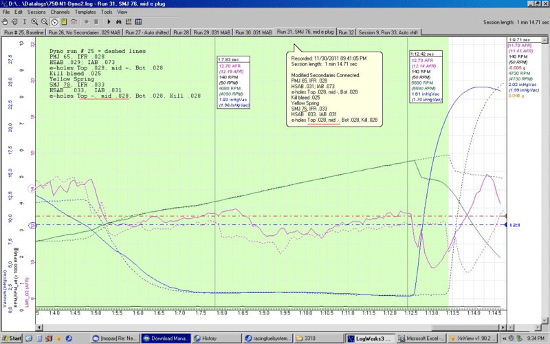

OK. Here's some I've already made screen shots of and marked up.
750 on the chassis dyno.
Solid lines is run #31, which is very similar to the 33 shown in the first post.
Dashed lines are an overlay of an earlier run with larger secondary jets, and a different pair of secondary emulsion holes.
Changes in power are difficult to ascertain as the rpm slope is the only clue.
But it is easier to see the details of the AFR and vacuum.
Those downlegs are going lean, then rich before drifting lean with rpm.
That's why in the photo of the carb you now see wires in the secondary main air bleeds. Would like to get back to the dyno or drag strip with the logger to see how much correction they are doing. I've also moved the secondary IFRs to a low location but that shouldn't anything but the start - if that.

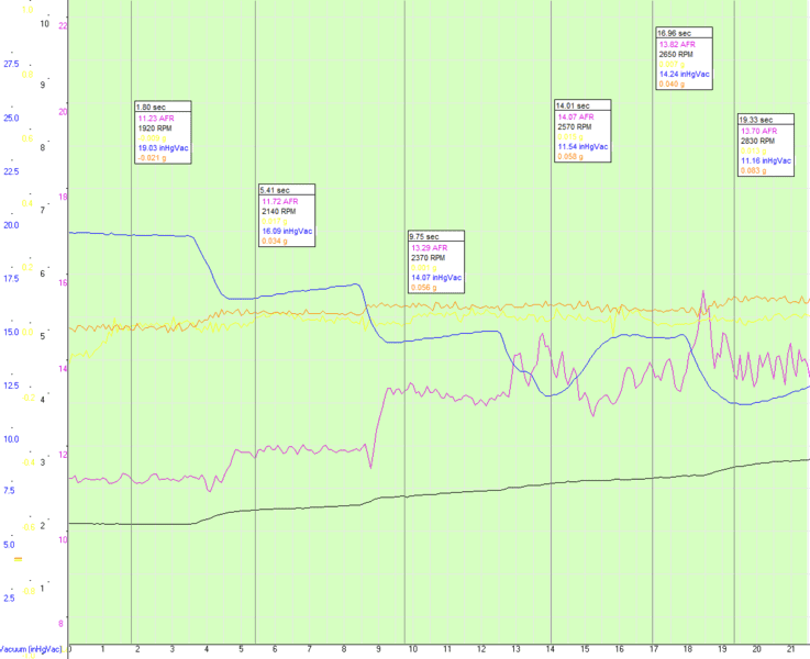

Next is some relatively low speed vacuum crowds. In other words, using the throttle to hold a vacuum reading.
This is the 650 carb and the mallory built MP distributor. With the converter tightened up a little, there were part throttle ping issues and a dead spot that was totally unacceptable for autocrossing.
The vacuum readings seem to be about 1.5"Hg higher than the mechanical gage. May be something to do with my conversion or the MAP sensor.
We can see that increasing throttle brings with it leaner mixture (violet), and more acceleration (orange), until vacuum drops below 12" on the MAP reading. Then AFR gets ragged and there's no corresponding increase in acceleration.
If this was done at higher speed, we'ld know that the power valve needs to open at this point. At these speeds, it was a maybe. Notice it did a little better at 2800 rpm. I think the kill bleed location was causing a delayed reaction on the main circuits. To be continued...
Throttle position would be helpful. It would let us better estimate how much portion is from the transfer slot vs booster, and also see motion related to pump shot.

A little follow up here.
In posts #1 and 9 the dyno runs reveal the downleg 750's secondaries were drifting lean from mid to top rpm.
So a question was whether I was able to correct that?

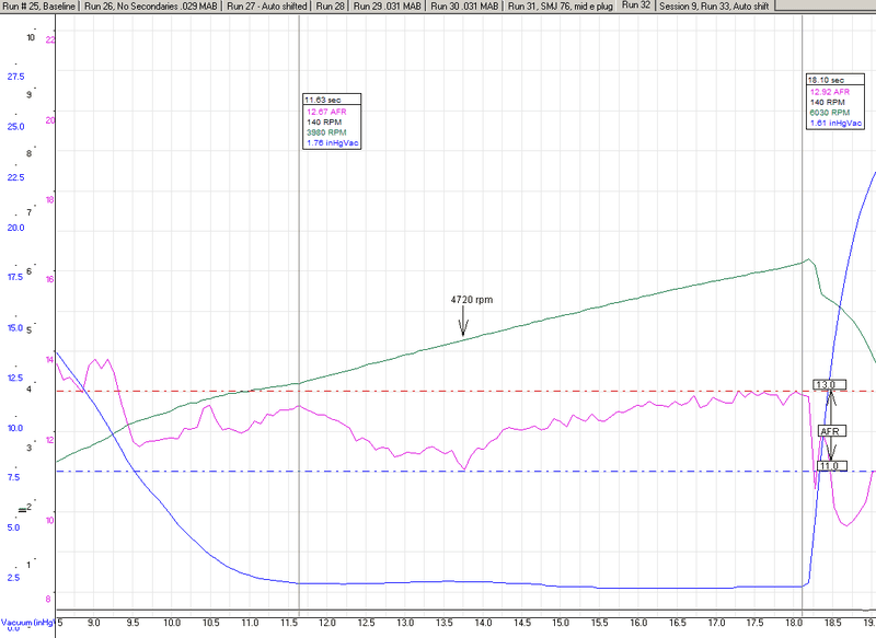

Focusing on just high rpms from the dyno that day and the one 1/4 mile run from last year we can see the answer is yes.
Dyno run #32 (same carb config as in first post)
Drag strip run focusing 2nd and 3rd gear.
Secondary high speed airbleeds reduced from .033 to equivalent of .029" dia.
In 2nd gear from 5000 to 6000 rpm, and in 3rd from 4700 to to the 1/4 mile stripe the AFR is now pretty flat.
Because the AFR was staying flat at the top the secondary jets could be further restricted without fear of going too lean.
In addition to jetting the secondary jets 2 sizes smaller, the secondary idle restrictions were moved to the low location and the secondary IABs reduced.
What is going on below 4700 rpm is harder to figure out.
The challenge with only one 1/4 mile run is twofold.
A. Although I got the car off the line pretty well I was rusty and unprepared for how quick the car was pulling. Result was I lifted a little and didn't keep the car truly straight down the track. Additional runs would have been good.
B.While the dyno run had the vacuum secondary opening controlled with a yellow spring, in the quarter mile run a plain spring with slower opening was used. Why? Because my intention that night was to change springs between runs. That never happened.
Looking at the vacuum (blue line) it seems reasonable to conclude that the secondaries late and slow opening may have contributed to richer conditions after the shift. We can see that at the 2-3 shift as well as the 1-2 shift. There may be more to it - maybe the secondary idle circuit is a bit rich.
Mattax is that afr trace smoothed or raw?
Also what's happening at the 3.30 - 3.50 mark with the afr?
Mother Mopar was right.....Put a TQ on it.
There's nothing wrong with a TQ but your post irrelevant to the topic. It's not about my engine or whether one type of carb is 'better' than another.
There's plenty of threads discussing, arguing, and some name calling about that, but that's not the topic here.
It should be raw.
As far as what is happening at 3.3-3.5 seconds, that's what I'm talking about when I wrote I'm not sure what's happening up to 4700 rpm in 2nd gear. Looking at the rise in manifold vacuum from 31.5 to 33 sec, it seems most likely the secondaries aren't opening soon enough. The velocity past those big boosters is certainly very high. Also the primary PVCRs probably need to be smaller.
Look at this run with no secondaries.
We see a similar rise in vacuum once it goes to wide open throttle.
Also the AFR was 12.2 with 65 PMJ and on the track the AFR is around 12.3 up to 4700 using a 64 PMJ.
It should be raw.
