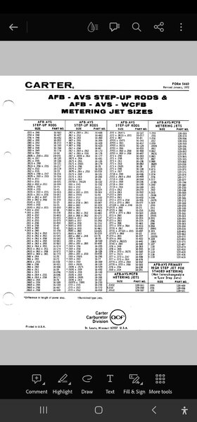

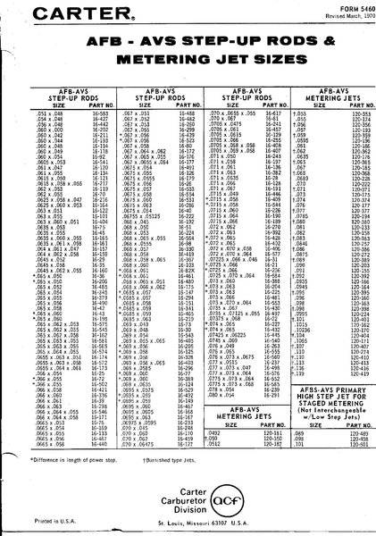

Acording to this chart, rods # 16-51, are 2 step, are they not? Not trying to be argumentative, perhaps I'm not fully understanding how to use the chart?
I can't read that chart, but Jim is correct, almost all Chrysler OEM Carter AFB and AVS rods were 3 step rods for use with tall primary jets. What carb are you working on? Have you pulled the rods yet? Do you have flat or raised piston caps? Do you have raised primary jets?
New AVS 2 carbs, flat top covers over rods.
I also cannot read the chart, but I believe GM used two-step rods in their AFB and AVS (yes, 1967 327 could be had with an AVS. I helped a friend of mine put it on his '57 283 back around 1980).
