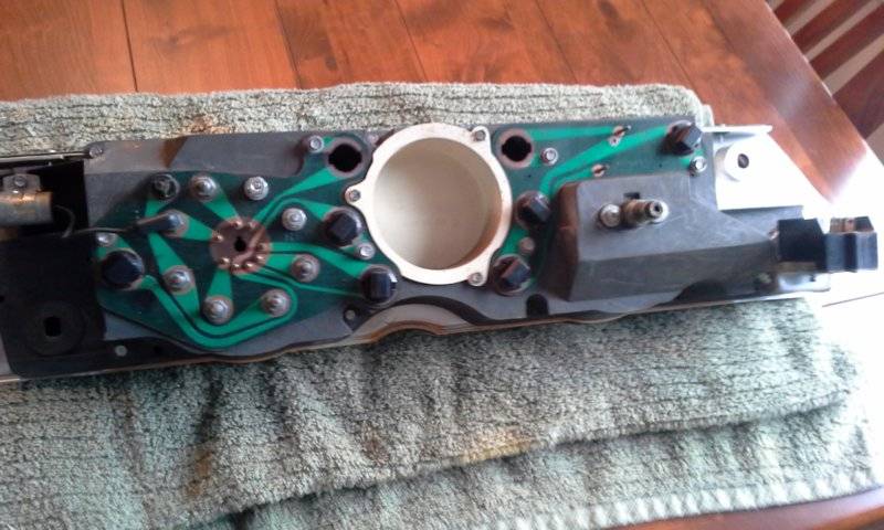

Hey Wayne here's pics of mine sitting on the shelf.

So armed with my newfound knowledge I ripped apart the dash
Discovered the coil on the right is the one supposed to heat up and break the circuit.
I made a power supply using 3 AA batteries and discovered that the coil had lost continuity. A little corrosion removal and the coil is working fine now. Note the gap on the contacts.

IMO the fuel gauge and limiter are close to retirement based on the pics.
Time to start searching for a better factory gauge for stock resto work, or going aftermarket.

Nice documentation! The pic with the gap in the contact, is that with voltage applied?
Thanks for posting Wayne
Yep, the contacts are open when voltage is applied.
I know there is a solid state regulator available but its too bulky to fit in the housing. I'll have to think of how to do a clean install
