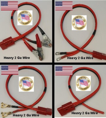

I would run one of these from the battery to the back of the truck
(In fact, I got on my my plow truck, to power my rear plow)
Put a quick connect on there and you can plug in your winch, or plug in a set of jumper cables or run power to a trailer or...

no, i dont use a winch for the rear plow (though my kids qaud is set up like your sandrail, with a winch)
i use a 2 way hydraulic pump, that is mounted under the bed
what i was trying to suggest is the way to wire it all up
HOLY COW!! I don't know how they can sell those that cheap!!! (Used to make wheelchair electronics, we used some of the big Anderson connectors)
i have no idea, i know they make it all themselves, and to order
so im sure they get a little bit of a bulk discount on materials, but they did seem rather affordable
