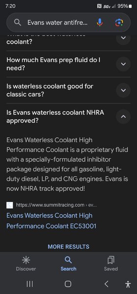

You have time to get some Evan's waterless coolant. NHRA said it's tracked approved. I would run just enough antifreeze to keep my block from cracking. Like what was said what about all the steering cars that race on the track with antifreeze. Also they said it's good to -40 degrees
Evans coolant
