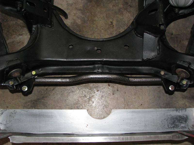

As far as looking more original, it’s not going to be a big difference. The 55917 is a little larger in diameter and narrower. That’s it. The 5906 is a larger diameter than the original, it just uses the wider original 67-72 mounting tab locations, which also limit tire width. Although if you’re staying with 15” rims the tire width issue won’t be a problem.

The Hotchkis bar mounts just like the stock one, so other than the bigger diameter and lack of a hump in the middle for the core support bracket, can’t see that it would be much lower. But I haven’t messed with one either so I’m not going say I am right.

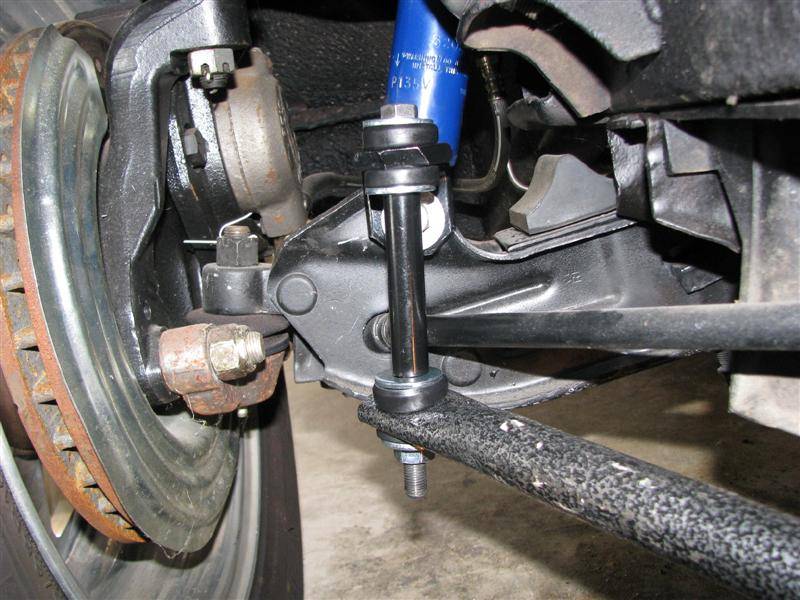

Looking at where the Hellwig 55917 mounts, it appears that it put the end links outside the strut rod mounts still. The 73-76 sway bar tabs are on the inside of the strut rods, so the #55917 probably wouldn't work with the factory 73-76 tabs.

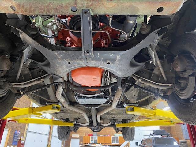

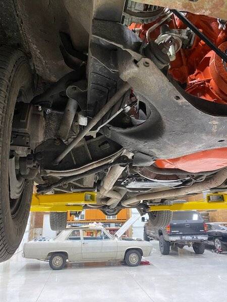

Running the Hotchkis sway bar on mine. It Definitely gives the resto mod vibe. Sits slightly lower than the k frame and it's huge due to being hollow. The bracketry is nice. I trimmed the outboard tabs off control arms and welded the inner ones supplied with the bar. I think the style given mimics the 73 and up location. I had my 73 up calipers to the rear. They could probably go upfront now?

Also, I prefer the 73-76 A style K member and sway bar design. The sway bar tucks up neater and in tighter. It weighs less due to it being shorter in each dimension while still being effective.
I've converted a few 70-72 cars to the 73-76 K member and steering linkage.
My 69 charger has the 71 k member and would agree on that, the sway bar tucked into k member is a cleaner look. To do that I had to cut welds on skid plate and re weld as the bar was too large to fit in without doing so.
