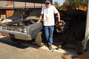

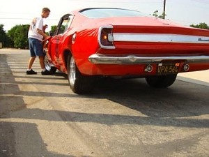

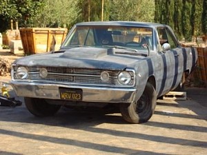

the car has been mini tubbed currently sporting a 275 /60 /15 tire
but should fit a 325/55/15 on an 8" rim
springs were moved in 3" and I used B body springs instead of SS springs, new 904 trans low 1st gear
rearend 8 3/4 391 gears
Motor is stock .060 over 273 with 509/292 Solid cam
sounds bad ***, but won't turn any heads at the track. Paint and new crate motor 360 are planned
