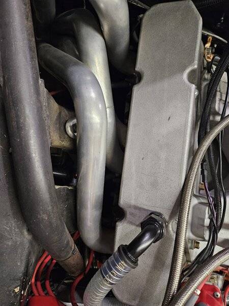

I used a set of Shumacher mounts on a bare 440 block and an empty 727 to set up my motorplate and used a factory trans mount to help set up. I don't recall having to do anything to the pinched but the car had had a 360/727 drivetrain at one point and I believe the pinch welds were hammered back then. An RB fits. The passenger side exhaust ports are awful tight to the shock tower. I moved the upper shock mount out about an inch. Custom headers were fabbed. It was not cheap and plug access is tough. I don't think I'd bother trying to find a manifold that fits.

The other issue is k frame probably needs to be notched for your oil pan and figuring out your steering linkage. A V8 dropped centerlink helps. If I had to do it over I'd run a dry sump system. I've got a custom pan with a window for the linkage but it's close enough to the rear of the block that you can probably avoid a pan window .

The issue is that a fabricator needs to be able to come off that port and take a 90. A 2 inch primary needs at least 2 inches to turn. There isn't 2 inches. But I don't know about a B engine. Hey drop one in and see.
