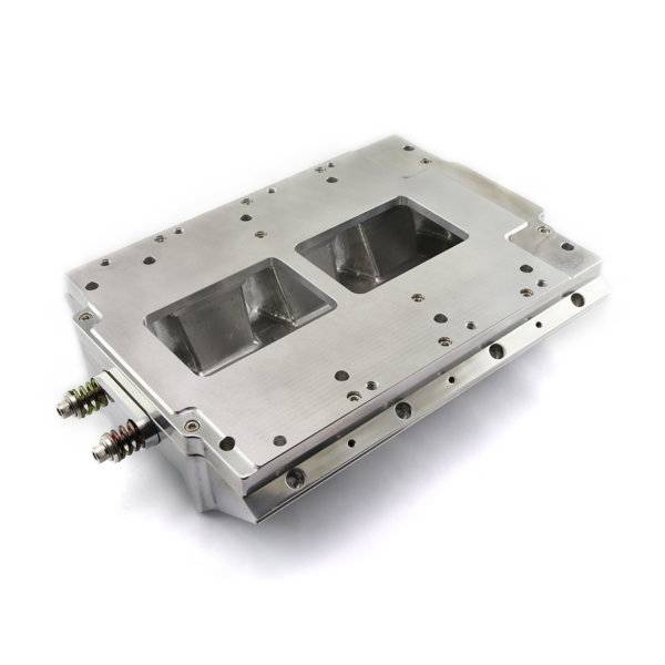

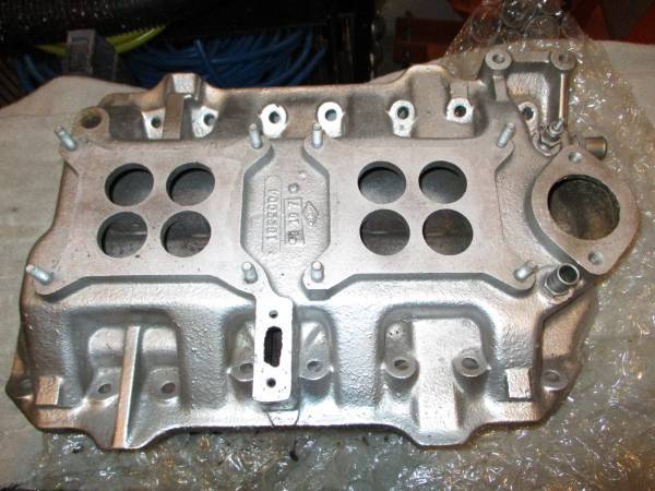

Most were made from Offy 360 dual quad manifolds plated.Haven’t seen one in years.But with polys kinda showing up here and there, who no’s. Not real hard to build.
Thanx for the replies guys.
I have an OFFY 360 single plane converted for a 360 LA (blown engine) but it was very restrictive.
I want to transfer all the blown parts over from my 360 LA to a +60 forged piston poly engine lol...

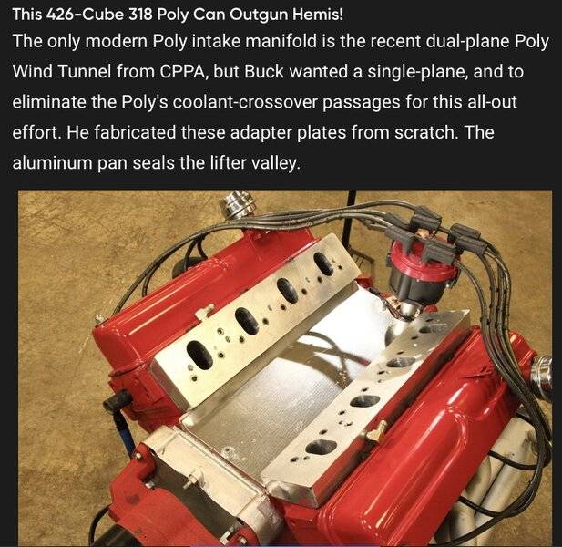

This 426-Cube 318 Poly Can Outgun Hemis!

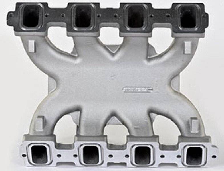

Apparently there’s intake manifold adapter plates to install an intake manifold from a gm LS1 onto a Poly engine.

Here's a couple of mine Offy single plane cut way down.Seems to flow quite well.The poly ones are similar,don't require as much cutting.
An Offy 360 (as in LA short block)? I'd sure like to see details on how this was pulled off considering the port spacing on an LA is vastly different from a Poly.
Offy 360 as in single plane.They were produced for most engines.Including the poly.They had a round circle with "360" cast into it.
Yes I'm aware of them for the LA series but I have never seen (or heard of) this being made for a Poly. A picture would be wonderful if you run across one.

The pictures of the Hinkles engine has me thinking about a LS3 intake for the Poly build?
Not sure if they have the same spacing as the LS1 they used???
