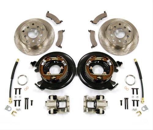

Cherokee Rear Disc Conversion. Going to fit these to my 8-3/4 BBC A Body rear end.
Takes a little bit of modifications.
72bluNblu pointed me to these links...
Jeep rear discs on an 8 3/4 axle solution
rear disc from grand cherokee on a 8 3/4
Looks like blue missile got it figured out and documented. Going to follow his lead.
Found this Cherokee rear disc brake kit on EBay for $387 shipped! So I bought it. New Open Box.
Have the 8-3/4" all apart. Was planning on new axles anyway. They will just be 5/16" longer now...
Same kit at Summit for $499... still would not be a bad price for all new parts.
