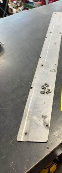

So, there's been a discussion about a metal brace that is specifically on the above said dashes only. I've checked my parts book and find no mention nor picture of this "stiffening" brace. Below is a picture of that brace but it has no p/n or Pentastar on it. Does this part actually ONLY come on ralley dashes for '68-'69 Barracudas?

I know it's not 68/9 cuda, but I have one from a rally dash duster/demon and it has that plate. I've seen them on all years of rally dashes. Like u mentioned, weird how it's not in parts manual.

All of the rally dashes have it. Without that plate the top screws that hold it up wouldn't have anything to tighten against

All 67 -69 barracudas were rally dash. This phrase is use for model cars that came with either Darts Dusters and Demons. But like I said all the rally dashes in 67-71 a body cars came with that brace. Do you need one?

Once again- all Barracuda's '67-'69 have ONLY rally dashes. Other "A" body cars like Darts & Dusters had a standard dash or a rally dash option. If you own a car with a rally dash, it must have the upper metal plate to mount the cluster.

That plate is the anchor point for the screws that attach the Bezel to the dash frame. Without it, the screws would just go through the bezel and not secure the bezel.
