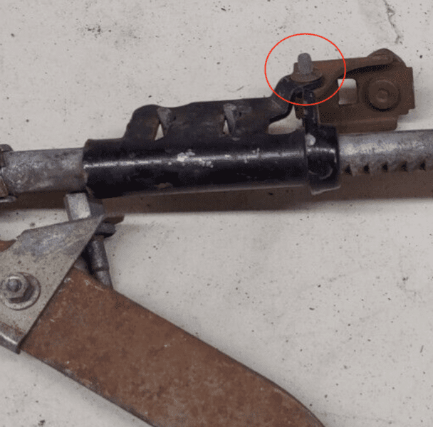

Looking for the pin that connects the e-brake handle to the dash mount bracket pictured below.
Can you replace the pin with a small grade 8 nut & bolt? Not many will sell just the pin unless they happen to have one to sell. I do have a complete set-up but don't want to part it out.
Understood but I just rebuilt mine and only need the pin. Is there a just a keeper washer on each side? Would you be able to measure the diameter of the pin? maybe I just get a small steel rod and cut it down to length and add the keeper washers on each end
It's just a pin about 1 3/4" long by 3/16" in diameter, flat head on one side & held in place with a small round push-on clip.
Not great pics but you get the idea.
You might also find a close match at your local hardware store too.
