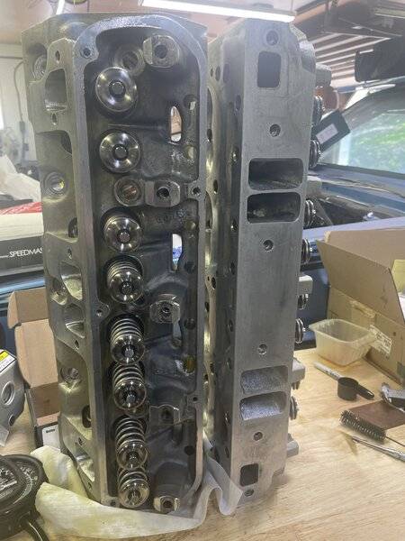

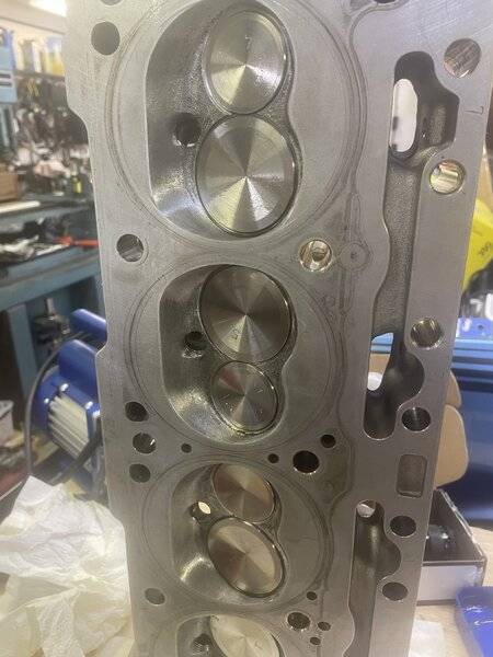

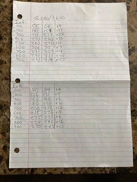

Finally have this set of 2.08 Edelbrock heads done.
pittsburghracer
Apr 20, 2016
15,871
36,458
Freeport, PA.

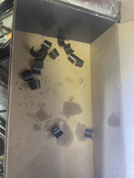

Took 6 weeks to get Manley 2.08 and 1.60 valves, keepers, LS springs (ya I didn’t stutter), spring locators, and valve locks. Well 5/16 locks came instead of 11/32. Took somewhere around 3 months to get this right minus -040 or -.050 pac 11/32 keepers needed with this spring to get the required spring pressures. The spring is only 1.280 diameter. I never do 2.08 heads for customers but this is a very good friend. Honestly I wouldn’t have done them to this size if I knew what chamber size I was limited to but with extra work they turned out ok. I was a nervous wreck assembling these small azz retainers and keepers not having a single spare but they are ready for pickup. These heads were ported by a friend before so I had a few repairs to do and had to cut them for the required .500 valve seals. Before and after numbers. Should work pretty good with his .680 lift roller cam.

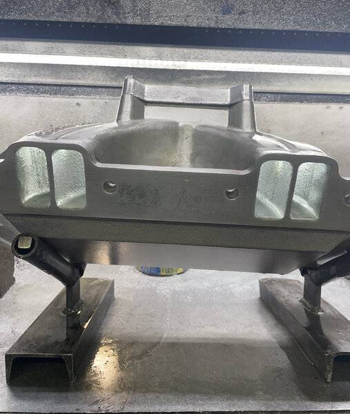

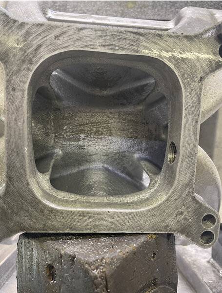

They are going to borrow my Super Victor that I ran 9.70’s with years ago. I spent a couple more day’s updating it to what I do now and it flows very well.
Wow that's a tight squeeze between them valves.
Been running mine like that since around 2010, 2012. Lol. Probably 3-4 different engines and they were used and damaged when I bought them, repaired them, and ported them. Best 350.00 investment I’ve ever made. Starting to smoke some so they are probably begging for a new set of valve guides.

Very nice work. I love the shape of your flow curves - that’s tough to do! You are a talent for sure.
Wow PBR you made what was already a decent set of heads great. Interested in hearing the old vs new ETs when your friend runs them.
Me too. He ran these a couple of years ago and I’m pretty sure he was usually running 6.50’s. He was kinda disappointed last year when he ran out of the box TrickFlow heads and I’ll ask my son but I think an M1 and ran 6.66 almost all year. He races at Norwalk a lot.
John, off the top of your head, have any idea how much taller a super Victor is over a Victor sitting on a motor?
I’m putting together a set of 2.055 Speedmaster heads right now with regular comp keepers and retainers and it’s like I can close my eyes and relax again.
I did I real nice post on this subject last year and measured an Indy intake, super Victor, and a Victor340. I Dont have a clean table now but working crudely on the floor it looks like with a straightedge across the plenum the super Victor is about 1 3/4 higher. In this one picture I set a one inch spacer on the Victor340 and the super Victor is still about 3/4 inch higher.
Thanks a bunch.
Just wondering if it would fit under my flat hood with a 1 inch spacer and a 4150 on it.
Victor 340 does, but I don’t know by how much lol…
Guess I could tape a plastic straw that extends 2 inches above the vent tubes on the carb and see if it bends when I close the hood
Thanks a bunch.
I’ll have this other set of heads done tomorrow. If you need a better measurement remind me later tomorrow and I can give you more accurate measurements.

I never cared for the super Victor till this year. Now I really like what I’m seeing.

Those should work nicely. My numbers are down on my last two sets because my customers held me back from what I’m used to doing as far as chamber work. Those were my last two sets of heads where the customer dictates that. A 2.08 valve should easily be over 320 cfm without restrictions on chamber. It causes me more work and not as good a set of heads for the customer.
Very nice job!
