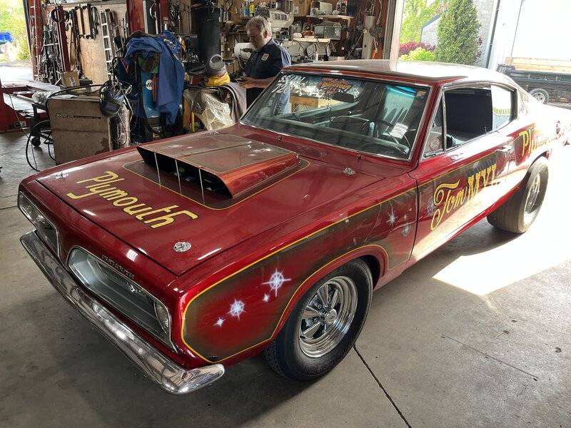

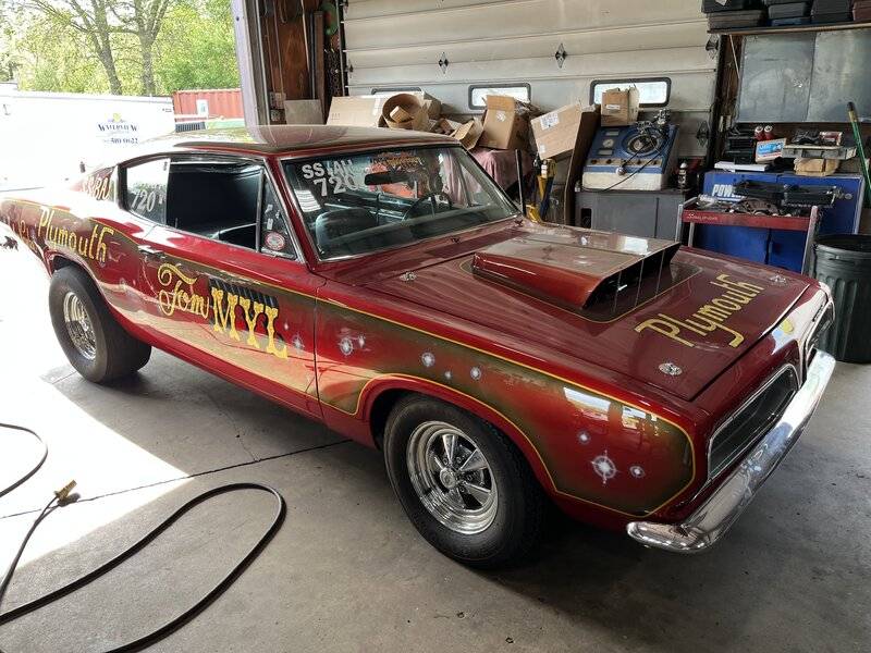

The racers in the hemi Darts and B'cudas didn't have to do anything. Cars came with Corning light windows - tracks and no mechanism, seat belt material attached to the bottom of the window runs up the inside of the glass and out the top of the door doubled over and and snapped to the bottom metal below the door panel. Unsnap the snap and drop the window. All from the "factory" (Hurst that is...). Except for the light glass it's easy to do and the mechanism weighs a ton...
The real 68 Hemi cars had deleted window regulators from the factory. All they had was a seat belt type strap that pulled the window up and snapped or fastened to the inside of the door. Did those cars even have door panels?
You treed me! So then, they did have door panels? Minimalistic at best, I bet.

took it all out except for the tracks for the window to go up and down in ...
Definitely had door panels to start at least. I always planned on taking more pictures of it, but not my car or shop. Was very nice getting a chance to see an original one. :)
They had the small bucket seats out of the vans and no rear seating. The odd thing was, all the 68 Hemi Darts I seen, had carpeting.
