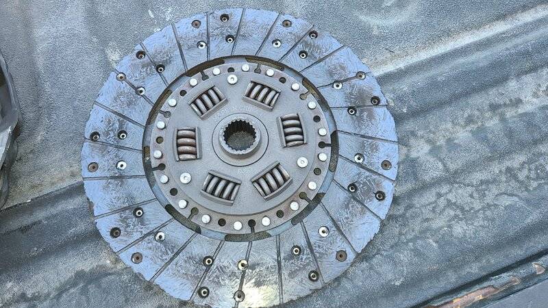

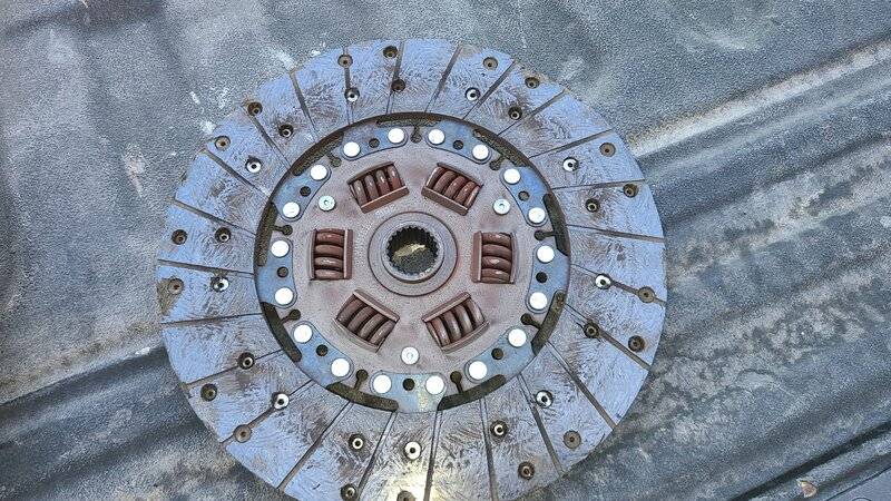

It came from a warrantied LUK clutch that came apart in less than 5000 miles. Springs all came loose. The replacement that I just took out let the throw out bearing inside the clutch fingers also within 3000 miles. Kinda glad pep boys doesn't sell parts anymore so I didn't attempt to warranty it. Picked up a rhino pak which looks stronger and better built.
the disc I took out and came apart on some of the edges near rivets and had uneven wear. Center on one side and edge on the other.
