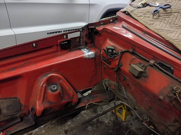

So.. i'm repainting my engine bay, orderd 2k urethane single stage paint.. i assume for primer i want to use 2k primer? just curious if there is a brand or something in particular i should look for? And does most primer not need reducer? (haven't painted in 25 years... don't remember much..) thanks guys
P.S. should polyester be fine?
I single stage my under hood and engine bay, wet sanded and scuff pads, anywhere there was metal I primered it, the prep whip in a spray can you can get at lowes And taped of for paint, prep wipe it again then spay
Ahh thanks! i forgot wipes.. ordering everything now.. new spray gun.. 2k primer, DA, sanding discs... stuffs adding up fast.. that bright red should look good hopefully :) gonna have like 600 into painting the damn engine bay (including the 2qt of paint i bought.. need to do fenders and lower quarters also.. )
If you don't reduce your primer, you may find yourself sanding out the course texture it will leave. No thinner, better fill for scratches and such. A little thinner and a few more coats. Read what your type of primer recommends. Usually, you can spray over just about any dry or cured primer with Urethane. Sounds like you're getting something decent.
Thanks, i ordered the UPOL 2k high built primer.. i think it will work out fine.. reading/learning a lot..
