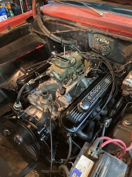

I've read 5,000-5500. 2001 engine, speedmaster intake, 750 holley, dougs d453's
I'm using an old MSD 6al box and currently have a 6000rpm chip. Wondering what chip I need to purchase just to be safe? Thanks
I shift mine (200,000 miles) at 55-5600 rpm's just because that's where it likes it, but I've had it to 6k multiple times no issues. I wouldn't fret a bit at 6k. That's with a small regrind cam and hughes spring kit. However, the bottom end is untouched
The valve springs and cylinder head ports will stop you when you get there. Just because you can doesn't mean you should.
Never been rebuilt? I think that is pushing it

Your valve springs will determine your limit.

I agree with Brooks. You will float the valves and it will quit pulling long before you have to worry about a self-disassemble.
If it floats valves, it damn well may disassemble itself. lol

well, when you said "safe rpm for stock" I was taking it you were concerned with the bottom end coming apart. If you just want to know where it will shift, you'll have to go by trial and error. I know the my '01 Ram has will turn 5k with kegger intake. It's still factory single exhaust and all.

Stock cam and valve Springs are done at 5000
My stock long block 5.9 is done by 4500, can’t miss it.

Sounds like a great start! If you are sticking to the kegger intake, they are not made for RPM's. 4800 is about where you are going to shift.

I’m worried about breaking parts.
