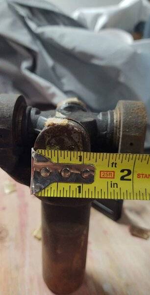

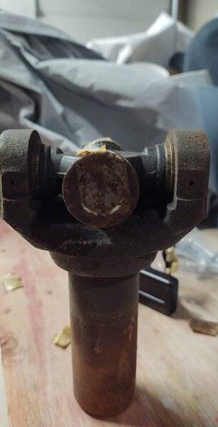

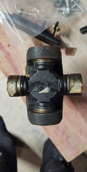

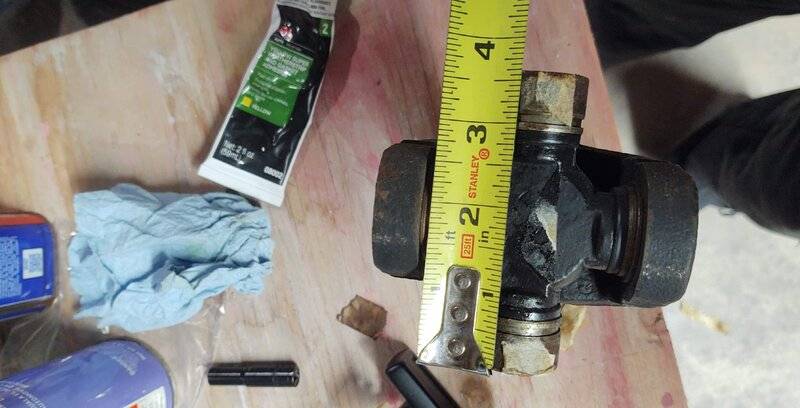

There is a OE application for a 7290 904 yoke. I can't remember what I got this one out of but the number on it is 52097955. Here it is in a /6 904 with a 7260 posing above it.
FWIW, I can't see a 26 spline slip yoke fitting because that's a 904 spec. Since you have a 383 big block, they only accept a 727. I doubt very much that anyone would switch shafts and I doubt it's even possible. The tailshaft bushing has to match too and they are a different diameter.

So that slip yoke was determined not to work with my application. So still on the prowl, but it is looking more and more like the conversion U-joint will be my best bet.
