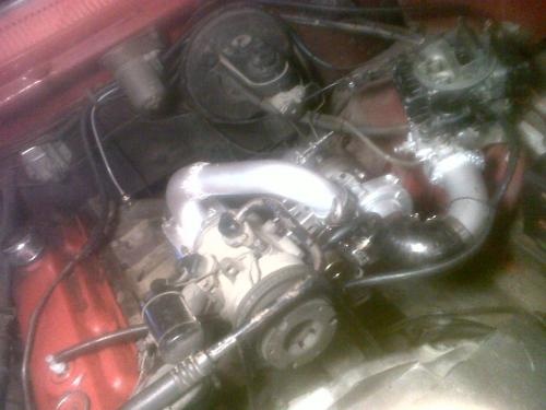

In my defense I did have a couple of beers while planning/fabbing this. Been fun, took it for a short test drive, I got just over 5 psi out of it putzing around town. Gonna be fun working on it again when I get back from my Independence Day camping weekend.

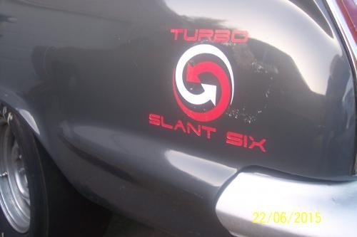

Got my decals on, finally!
