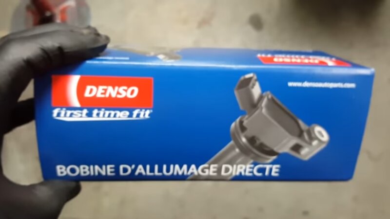

Sounds like the exact same thing I went through with my Ford E150 5.4 Triton, missfire codes.
Replaced all spark plugs and all coil packs, the Good Denzo coils through Rock Auto with Motocraft Plugs for the Ford.
Running like a million bucks now. 2 day job all crammed up underneath the firewall on those vans. Took my time and got it right.

I located a good guy on youtube who was well versed In the Ford Triton 5.4 and 4.6 v8s. He uses only the Denzo coils and Motocraft plugs for the Fords.
So I went with those off of his recommendations on my 5.4. Solved all of my misfire problems and still running great today, even after running a 1700 mile cross country trip.
Still perrring like a kitten.
