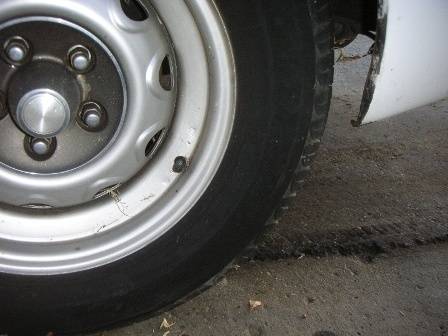

I fit 245/60/15 on my 68 dart by moving the fender support forward by drilling a extra hole on the bottom fender lip. The hole will be forward of the stock hole.

This is what I did. The hole at the back is factory
