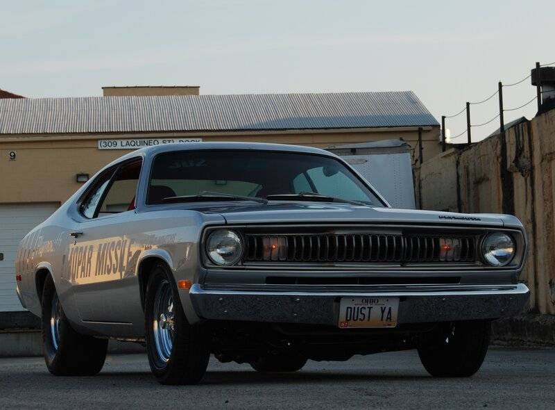

My plan is to do a maxi-mini-tubb (plus 3/4" per side) , add the latest version of the 4-bar package similar to my silver Duster, but naturally I have picked up a couple of mods for Ricks application to allow for behind the axle coil-overs / panard bar and full exhaust without moving the axle centerline forward. A Strange 9" /w 3:25 gear is Ricks choice for differential. Works out well since I am a Strange dealer. Up front HDK will supply the standard HDK power rack and pinion / coil over install / anti sway bar / Gen III engine mounts package along with a semi-removable / bolt in enlarged tunnel for the OEM 8HP80 transmission with the Holley transmission crossmember mount.

might be...I'm less than 100 miles away and would love to stretch the legs on my silver Duster. I usually just go to the Mariott / host hotel till about 9pm....then cruise back home. If the weather is nice it is a great trip.
