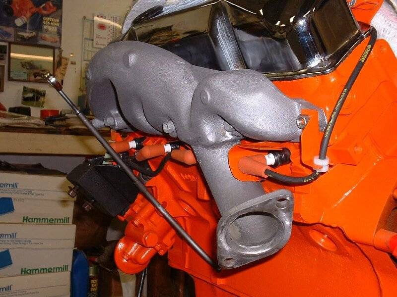

You could always use one of these that were made by Accurate Exhaust a while ago. I have one for a 440 but they aren't cheap or have someone make one out of a C-body manifold...
What was the price of that exhaust manifold? Was it sold in a set? Was the application specifically big block a body? How long ago did the make them?
They made very few, one size for a 383 and one for a 440. I have a 440 one and saw a 383 one for sale at Carlisle a couple years ago, but I have no idea how many were made. You can make one yourself if you know how to weld steel pipe onto cast iron...
Very interesting. I never knew they existed. What year were they offered? It would be cool to find a 383 version.
As far as making one is concerned, it's not out of the question. I think it would be easier to use a b body manifold.
