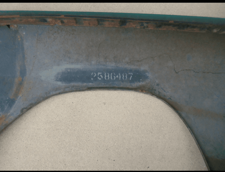

Part number on I side of fender
Interesting that the SAE date is 69?

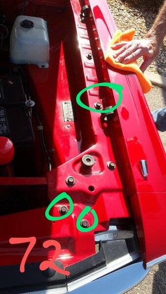

As for other years...
No crush ribs, 2 bolt holes not used in 67.
Crush ribs & 2 bolt holes
Crush ribs and bolt holes
