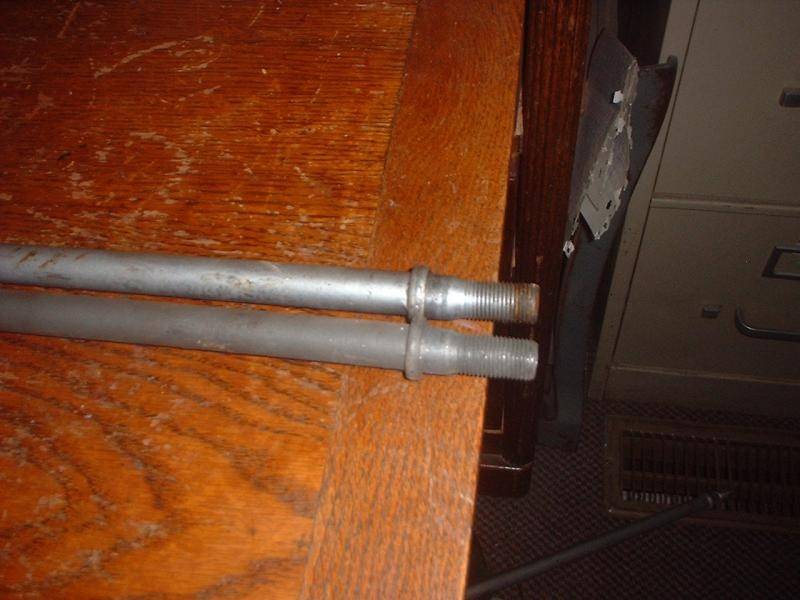

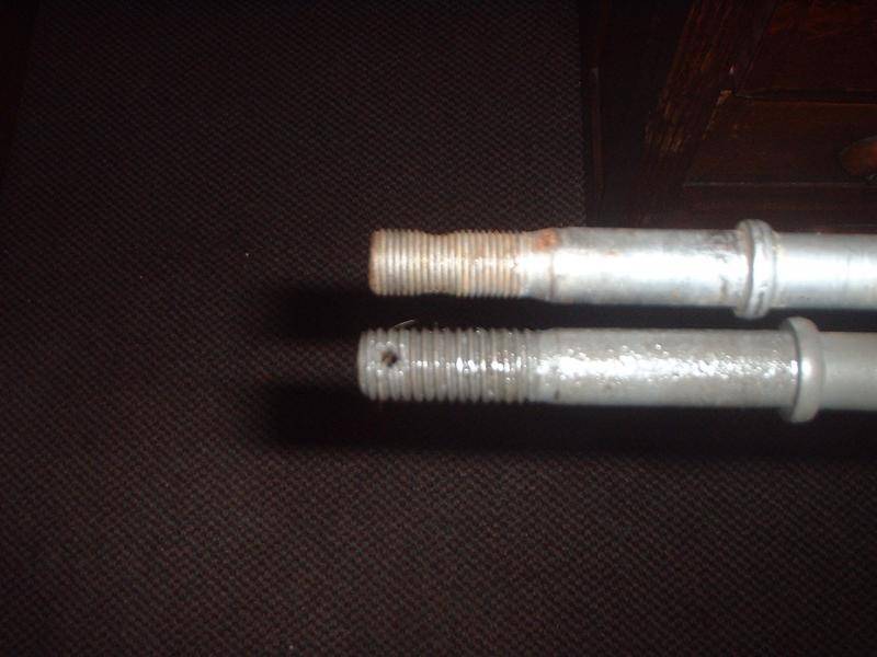

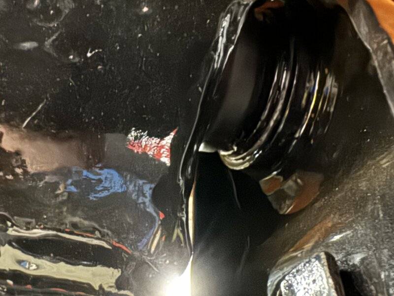

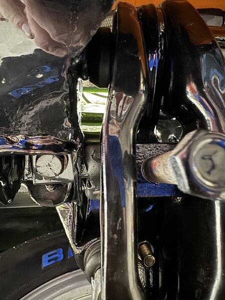

We used the urathane bushing on the lower control arms and it appears to be really thick. On the passenger side it doesn’t look like it’s seated forward as much as it should be. Is it possible the strut rods are to long? They came with the car so not sure why they would be but it almost seems like it. The tortion bars seem like they are seated ok, might be able to move forward a little if I cut them down? Is it possible the ball joints are to long, maybe the knuckles are flipped drivers to passenger side?What’s everyone’s thoughts.
