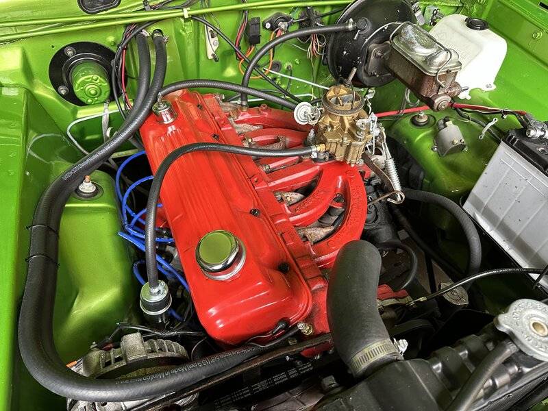

Here’s a pic. Looks safe and clean to me. Room to take valve cover.
Maybe for street cruising, if You keep an eye on the hose over the exhaust, better yet slip reflective fire sleeve over it. No matter how it looks, or You feel about it, that will get You bounced into the spectator bleachers at any track I've ever been to for at least the last 35 years.
