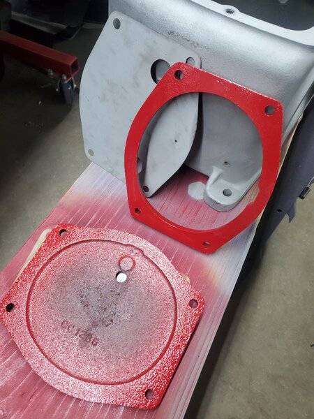

Here are a few updated pictures. The pump is pretty much ready to assemble again. I blasted everything and painted it. I took the head apart and cleaned the valves. I am waiting on a seal before I can assemble the pump. Then I just have to paint the motor and put everything back together.
