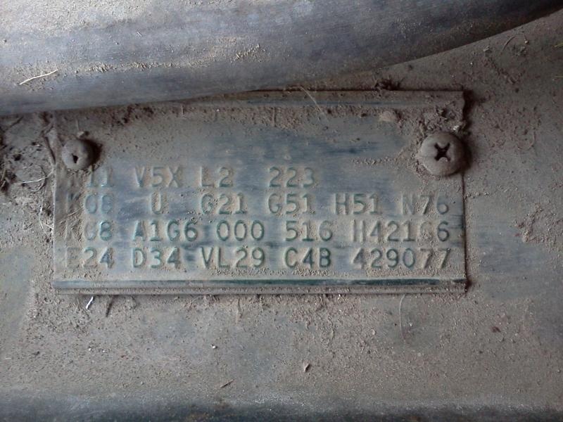

where do i find the data tag? and i checke dthe rear last night, im certain it is a 7.25

The data tag is attached to the driver side inner fender just to the rear of the battery.
You read them bottom line 1st and then go up one line and then the next
Post yours and we can figure it out really quick.
Here is the data tag and I'll work on getting a picture with the wheels off.

VIN # VL29C4B429077
E24 225 /6
D34 Standard Duty Automatic
VL Valiant Low Class
29 2 Dr Sport Hardtop
C 225 /6
4 1974 Build To 1974 Model Year Specs
B Hamtramck, Michigan Assembly Plant (Dodge Main)
429077 Sequential Body Number
KG8 Deep Sherwood Green Main Body Paint
A1G6 A Class Cloth/Vinyl Green and White Bench Seat
000 Full Door Panel
516 Scheduled Build Date May16, 1974 (Thursday)
H42166 Order Number
KG8 Deep Sherwood Green Roof Paint
U Build to US Specs
G21 Clear Glass
G51 Driver Side Manual Chrome Mirror
H51 A/C
N76 Coolant Recovery System
W11 Deluxe Wheel Covers
V5X Black Body Side Mouldings
L2 Build On Assembly Line 2
223 Unknown I am not familiar with this #
No disc brakes !!
Simple ain't it??
